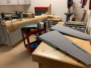

The short answer is I cut both parts out of ply. My kit (Precision Cut Kits) supplied both parts, but.... I used the fuel tank floor as shown in the plans, however, if you are making the firewall removable with the fuel tank tray on the back side, you will need a second fuel tank floor - that's the one I cut. I believe the removable firewall is a great idea. I've never done this before, but Sam P is a master of practicality. This removable fuel tank floor slides right above the fixed floor in the fuse that I'm assuming is also structural. The cockpit floor came in my kit but was not quite long enough. In the end, I think I measured mine just a little too long based on the info from my dbalsa kit. I believe 21.5" is the number.
I'm waiting for boB on RCSB to start the cockpit to see some of the stuff he does. I'm thinking I will use some of these parts, but maybe enhance some of the panels (either construct my own parts or modify).
Since you are in the beginning stages, I'll share some other things I would have done differently. (1) I would have probably made my flaps like boB or Kalima did out of solid or G10 sandwich material. It's obviously more stable plus easier to detail. (2) I also opted to remove my life raft hatch and also the stuff for the opposite side hatch. My rationale was - I'll never finish this plane with all this secondary detail plus I imagined that these hatches would be problematic later - like popping open in flight etc. Same goes for the rear gun tunnel. I will detail it on the outside using polystyrene. (3) I think I would have tried to figure out a way to move the servos out of the back stab. It's an extremely practical and solid way to control the elevator halves but will undoubtedly cause the need for more lead weight in the nose. (4) And I would have scaled down my aileron control attachments. They are robust for sure, just too big.
Ah, hindsight. All else is Ok. My fiberglass issue was resolved. I just needed to walk away for a week or things would have gotten ugly. I think I had a couple things going wrong. My Zpoxy might have been old. I'm building this along the coast north of San Diego where it's really humid. And I needed to let the epoxy cure for longer than 24 hours before pulling up the peel ply. I switched to West Systems and things seem better. Most of what I had done was good, just needed more cure time.
I still need to finish the cowl attachment - more of something like boB did and also follow his lead on the cowl flaps. I also need to figure out the layout of the brains for this on the servo tray and how I plan to access it via a hatch. These are things that paralyze my build.
I also need to post more pictures, but in truth it's nothing you wouldn't see elsewhere. I finished detailing the control surfaces, working on the flap detail and almost done with the landing gear covers and wheel well detail. But I'm spending more time watching boB's build.

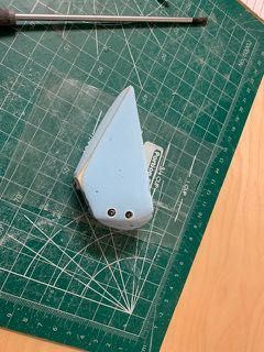

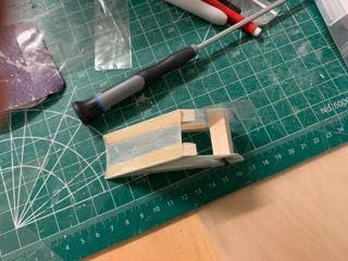

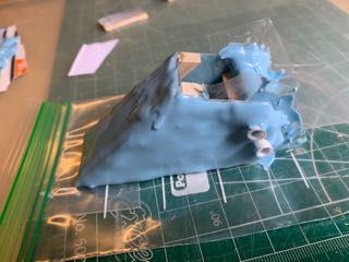

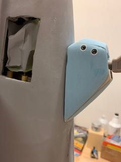

This is what I did for the carrier version of the tailwheel body. I made a simple frame, with the rear removable so I could take it on and off without having to remove the wheel. I used hardwood and G10. The top rails slide next to the hardwood block that the tailwheel is routed through - I plan to screw the shroud into that block.
I added some polystyrene sleeves around the screw heads to serve as a way to recess these heads.
From there, I added on the poly fil. I like this stuff because you can cut it easily with an exacto while it's hardening up. It's fairly light and tough.
First pass at shaping

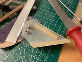

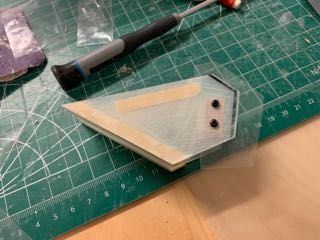

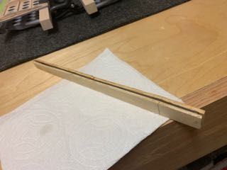

I made my mast out of 0.020" G10 with hardwood on each side. My thought was that the G10 will hold up and provide a stronger antenna line attachment. On the other hand, if this thing takes a hit, it will probably rip the nose of the plane off.
Rough piece
After shaping and creating a G10 sleeve for the mast to slide into.

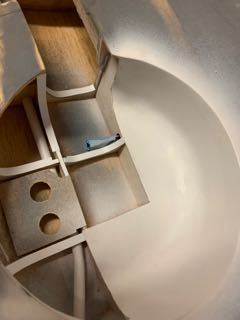

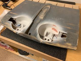

Wheel wells were trimmed out. I can't emphasize enough that it's so much easier if you make a decent, smooth plug that produces a good interior surface. Or plan to add filler and sand and add filler and sand etc.

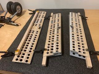

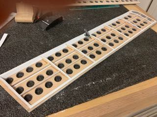

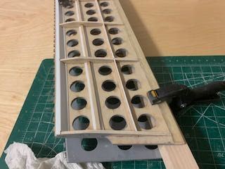

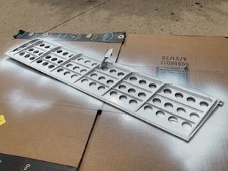

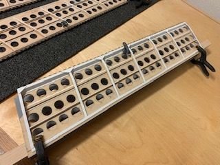

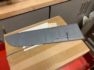

Saw some good flap detailing on boB's thread that I wanted to try. My first attempt looked like this
I was pretty happy with this, but I realized I needed to shave down the ribs so there wasn't interference in the closed position. I also added a strip of G10 at the TE and more polystyrene per the full size version. I also attempted to create the slope on backside of the LE spar. I only did one flap, which I'm glad, because I decided to modify this before doing the rest.
This seems better. The G10 is recessed. Ribs are shaved down. I need to add the caps on the ribs (the reason why I needed to shave the ribs down) and the junction plates and then replicate on the other flaps.
As a side note, I keep the flaps clamped to hardwood that I've checked with a straightedge just to prevent any more warping. I have a feeling that the G10 strip that I routed in at this thickness won't help keep things as stable as I'd like. Again, a reason to go with full or sandwiched G10 material for the flaps.

Bob, were your flaps flat before you added everything? Im just wondering if they warped after, because all of mine are very flat. After reading about this issue, i made sure all of mine were in a flat position under weight.

That's a great question.
I had my kit for about 2 years before I started on it. That's going back to 2016 or so. I'm not sure but I'm guessing these were flat on the bottom of the box (it was a full kit). I always tried to keep them flat but I seem to recall that a couple had a bit of curve in them before adding any ribs or spars. You can load them up with weights but I'm not sure if that will do much once the weight is removed.
Once this plane is full assembled, I will likely find a way to pinch the flaps tightly shut when in storage.

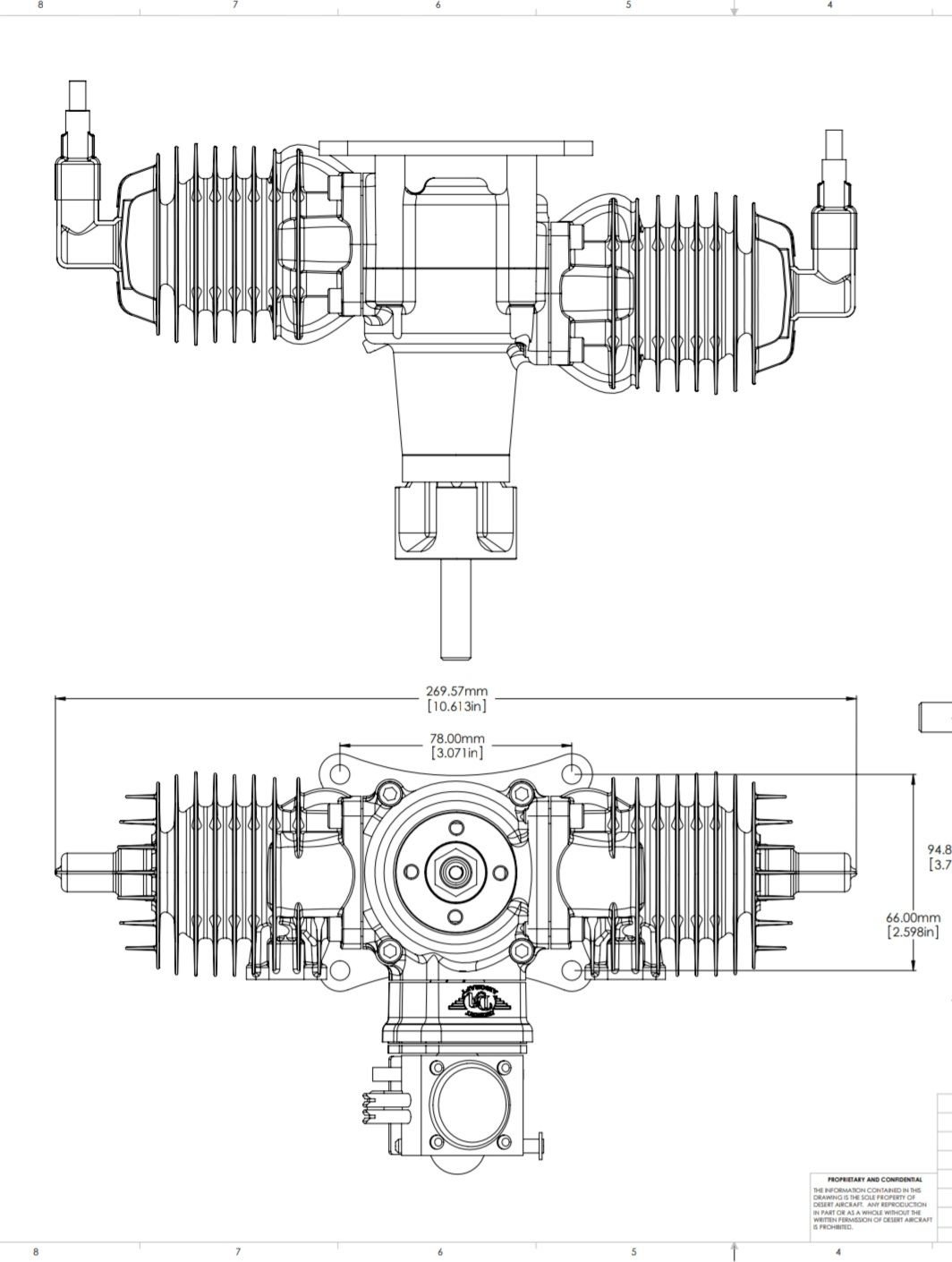

Way to score on the TF kit. I hear great things about those and have read all the threads on that kit to help me with my Bates build. I was warned about the F4U, but I'm still glad I'm building it. I already have a second kit from Bob Holman - he is awesome! I'd like to find a way to build a F4U-1 from the -5 plans. I clearly don't know what I'm talking about yet.

Thats ok, I dont know what -5 is myself. Its funny too cause I bought my kit back in 2018, so I had mine in storage for about 2 years as well before starting. I was waiting to get a decent place and a good bench to work on.
My flaps have been flat since I got my kit, I checked all my parts when I got them and my flaps were good and flat. Ive just been keeping them under a bit of weight to keep them from getting any ideas.

Yea, the GT80 is probably what Ill get as well. Especially since they are on sale till next friday. Cant hardly pass up saving a couple of hundred, nor really justify spending $2000 on a radial. Although UMS makes a couple that would probably work good.

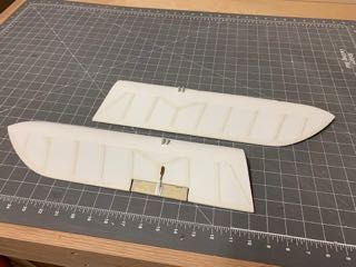

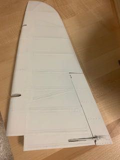

I have the flaps finished and primed on the inside. I realized, after I was all done, that I should have done this in aluminum metallic for future weathering, but then I'm not sure how much wear I've seen on the inside of the flaps. Lots of dirt, oil & other grime.
with rivets and paint. I've seen some examples of the center flap painted white on the inside. And some red. Not sure if one of these versions are restorations???
One other tidbit of advice is on keeping the hinges clean so the wires are easy to insert. I don't enjoy that part much. Also, as I mentioned before, pay attention to the rib height as it impacts how the flaps close. I tried to taper to the TE to the best of my ability. The double thickness of the flaps itself is rather thick compared to the aileron right next to it.

Well I took a second look at my flaps and of course they decided to start warping on me. I've tried adding weight, but as you guessed, it didn't do anything at all. A couple of them are actually warped and twisted. I'm thinking of just using a fiberglass laminate for the whole thing. I've been doing a little research and 6 layers of 9 oz fiberglass should get me close to the 3/32" thickness I need for the flaps.

Regarding the flaps, did this happen after you added the spars and ribs? If yes, I'm not sure what to say. I also don't know if you are thinking of adding the 3/32" FG to the existing flap or using the 3/32" as the flap by itself (sounds like the latter). But the idea of making an equivalent to G10 on your own sounds a little challenging but maybe if you lay it down on a thick piece of plate glass with saran wrap over it???

The flaps warped on me before I added anything to them. Am I overthinking this? Should I just build them and hope they stay flat? Yes the idea was to build my own G10 type material from scratch. But if its not necessary that would be awesome, as drilling over 300 holes in new material isn't something I was looking forward too. I'm just afraid that the flaps won't lie flat after they are built.
I know too that any dips or high spots are going to have to be addressed before any attempt at glassing, as its much easier to fill and sand before hand. Does it matter what kind of filler material I use? Will it affect the glassing process at all? I did use Windex and saturated my balsa and clamped it in place, left it overnight to dry then glued it down. I'm just trying to figure out how to do it without adding so much more work to the project. I should have realized that tape would be the best way to go.

Flaps: I forgot to add that, depending on the hinge you will be using, you will get some rigidity (and straightness - if that's a word) along the LE edge. I like to do lots of things myself, but I would probably find someone to make the G10 complete with laser cut holes. My fear would be wrecking the flap as I'm almost on the last hole.

Great question. My plane is at a different location, so no way to get my hands on it.
The GT80 shows a width of 257mm. I saw on Sam Parfitt's thread his comment that there was about 1/4" clearance on each side of the plug with his GT80. Appears your DA70 twin is about 1/2" wider so it looks to be tight. You probably already knew all this.
Wish I could give you a definitive answer.

Appreciate the feedback. Yeah..tight fit..might have about or less the 1/4 inch from cap to cap. Arrrr
..will keep hunting for a engine that will fit (without chewing the cowl) . To bad Zanoah GT80 availablilty is in Europe somewhere ..would hate to start looking for replacement parts and waiting weeks to arrive.

I looked into this same issue a lot. The twin 70 has plugs that come straight out, whereas the Zenoah gt80 the plugs come out at an angle. You could get the heads inside the cowl I figure, but you would have to cut holes and put plugs in each time you remove the cowl.
I decided to get a DLE 85, going to mount upside down. I think ill still have to cut a hole, but with only one plug I think I will be able to roll it on.
