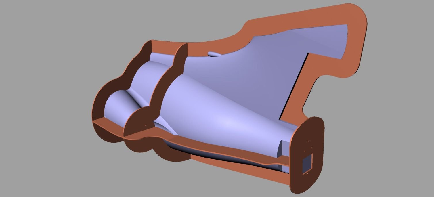

You going to be able to get the rear section out of the mould with the duct return curves?
Dave
Dave
Dave (and Oli),
Good question which I have thought about, but will look again. The concave undercut on the fairing just behind the exhaust is a risk for trapping the mold, but I was thinking that with the fin area and rear section released, the front part of the mold would release to the rear as all the curves taper that way. It does rely on a slightly flexible mold though, which isn't a great idea.
More thinking to do - thanks for the comments.
Paul
Old 01-04-2019, 07:01 AM
  #160
Dave Wilshere
Join Date: Jun 2002
Location: Watford, UNITED KINGDOM
Posts: 13,106
Received 735 Likes on 531 Posts
Either separate engine pods or a silicon insert that will flex out would be required from what I see. Were you moulding the fuselage in sections and joining too? It will add weight and make consistency and stability in the surface contour harder?
That fuselage is a complicated moulding!

Just for ease of molding and fitting out, I was planning on having the fuselage split into 3 pieces just like the plug, and then bolting together (just like my DerJet Hunter).
I think it would be possible in the future to make a single piece fuselage using the same molds, as long as I get the molds bolted together accurately.
Old 01-04-2019, 08:03 AM
  #162
Dave Wilshere
Join Date: Jun 2002
Posts: 13,106
OK, but that adds a lot of weight. I’m sure access into the fuse is going to be a problem once it’s assembled

Originally Posted by JSF-TC
Dave (and Oli),
Paul
I doubt. It looks like the release angles in that direction are too shallow. The mold is funneled by the engine pod.

I just can't believe how much work this saves, being able to design the parting planes in cad and not have to trace them out and cut and fit and trim and scrap and redo....
Also on that area that looks like it might trap the mold, you can lay in a slug of silicone rubber and form a bit of a glove mold, but just over that one area.

Updated rear fuselage parting planes to overcome the potential for trapped parts due to the negative draft angles. What a great resource RCU is with all the help and comments.
I may be able to make the forward bottom mold section in one piece, so it would be a 7 piece mold, otherwise it will be in 8 pieces.
My current thinking is to make the flight rear fuselage in 3 pieces, upper left, upper right and a lower half, and then assemble with the internal structure into a single part.
The arrows below show the intended mold removal directions, notionally perpendicular to the surface.
Paul

Paul
i don’t want to keep being the bad guy, what you have done is just amazing. This rear section is going to be critical on weight, anything extra back there is going to need nose weight added, each section you join will need tape and filling. It’s also lots of moulds.
i would cut off the turbine ducts, then you could make two half moulds for the whole fin/ rear fuselage, the pods then require two split moulds to produce each side. You may even be able to make them a removable section on key ways and pegs if you do end up with the turbines back there.
Dave

paul,
looks much better to me!
im assuming you would assemble the top Left and Right pair of molds (the sections with the V. Stab and engine exhausg undercut) as a single layup?

Im assuming you would assemble the top Left and Right pair of molds (the sections with the V. Stab and engine exhausg undercut) as a single layup?
I was thinking that I would do the upper left and upper right as separate layups, then combine with the internal structure (fin spar etc.) and close it up with the lower half, and lay tape over the join line from the inside. Getting down into the narrow fin area as a single layup seems too difficult, especially when vacuum bagging too.
Paul

Originally Posted by Dave Wilshere
Paul
Dave
Dave,
Appreciate the feedback.
At this point I think I have settled on a forward mounted engine configuration, but with the engines slightly inboard so that there is only one bend in each pipe, a long way back from the engine, similar to the DerJet Prowler solution, so that will help with the concern over being tail-heavy with the engines behind the c.g.
I don't think I could face cutting off the engine pods at this point - too much invested in the plugs. Not sure it would really save too much weight either compared with a single piece rear section, albeit composed of 3 or 4 separate moldings. It is only the molds that will be in 7 or 8 pieces, the actual flight parts will be laid up across multiple molds at once.
Paul

Wet lay up and join would not require joining tape or glue and would not increase weight!
It’s a bit tedious doing an overlapped wet joints but it does mean you have a continuous moulding, this insures strength without gaining weight!
Downside: You have to work quite fast depending on the resin you use!
Paul
Paul,
sorry, i should of been more clear. I meant doing each pair of Upper left molds and each pair of upper right mold layups separately. (Ie the upper left 2 molds would be “assembled” and then its layup done, then the same for the right. Afterwards the left/right molds halves would be joined with the structure).

Thomas,
Yes, that's exactly my plan.
